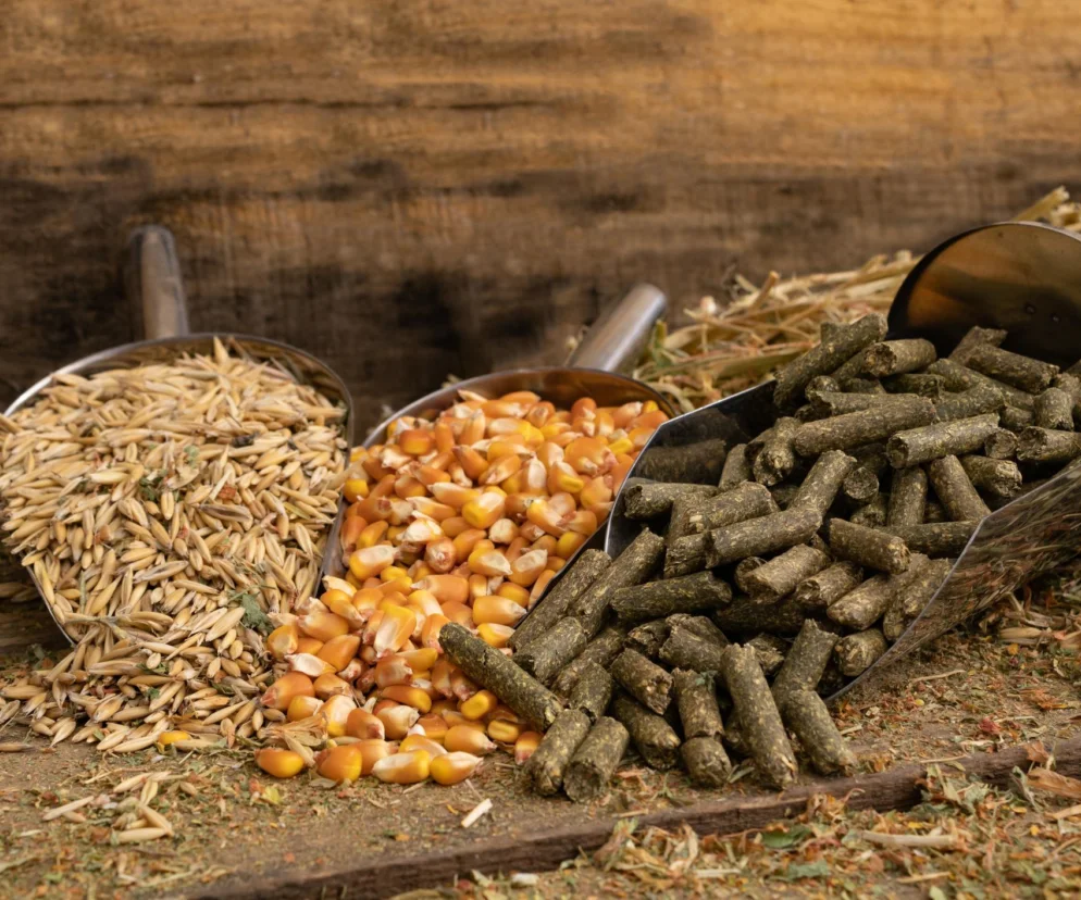

Pellet kukurydza, owies

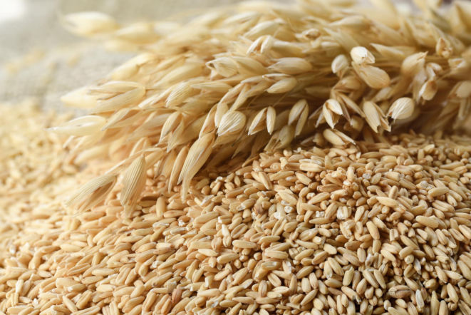

Owies
Autor: Tatyana Berkovich/ Getty Images Ziarno owsa
